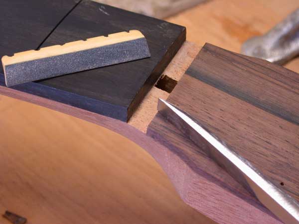

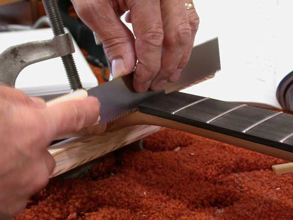

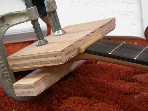

Here's what I do.
I start with a rough nut, sized on its fitting surfaces, bevelled on the bottom, not shaped on top nor cut to length. The bottom of the nut is bevelled on the disk part of the disk/belt sander, with the table at the desired bevel. A plywood guide is bevelled on the edge using the same table setup as for the nut. The nut and guide now have identical bevels to match the headstock angle. The nut is placed against the end of the fretboard as a spacer, then the guide is clamped very snug up against the nut, like this.
Remove the nut. I now have the guide's bevelled face coplanar with the tuner side of the nut. Using a small Japanese saw, or X-Acto saw, cut the end of the headstock overlay while pushing the saw up flat against the guide. Stop just shy of the neck wood.
Break out the cutoff of the headstock and clean out the slot with a narrow chisel. Sometimes
I use an old nut with a piece of sandpaper glued to it.
We now have a slot sized to the rough nut.
Shape and finish the top portion of the nut. This one still needs some material taken off the height.

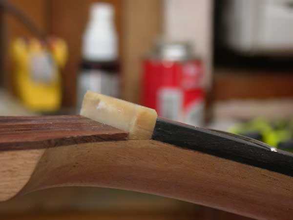

I carved a couple of necks with the nut in place after I saw a picture from the Martin factory where they did this. Didn't care too much for it myself, I thought the nut was a bit "in the way" of the shaping, so I'm back to my old ways...
PostPosted: Thu Sep 27, 2007 5:51 am
Posts: 1667
How does it get in the way? Do you have a photo of the area on one of yours? I'm curious to see your neck.
PostPosted: Thu Sep 27, 2007 6:38 am
Nothing special about this area of my necks as far as I know. I thought it was easier to shape the concave shape from the headstok towards the neck shaft without the nut in there, that's all. Here's a recent headstock, unfortunately the nut is not to clear in the picture but you get the idea.
PostPosted: Thu Sep 27, 2007 9:17 am

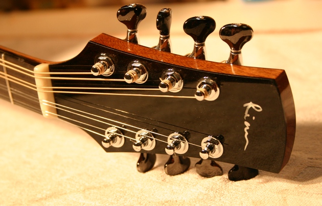

Rian, that's a beautiful bouzouki nut and finish job. I just enjoyed it again this evening. My nephew was over and I showed him Andreas Aase playing it on You Tube.
